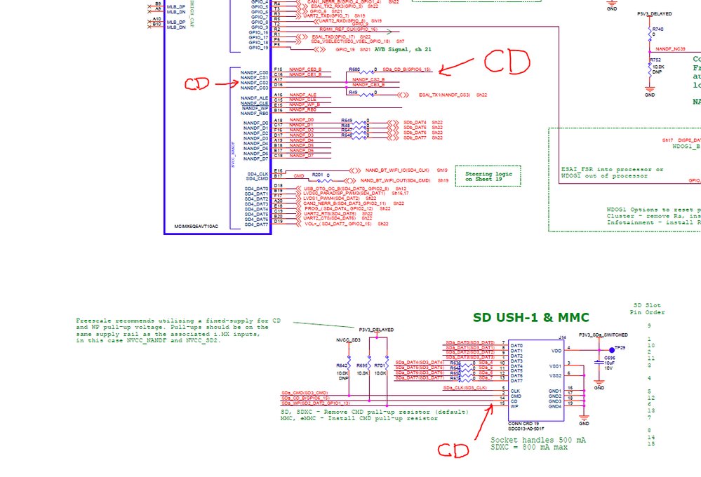

  1. Sabreauto SD interference
    In Sabreauto reference board, NANDF_CS2 is using as the “Card detect” pin of SD card.

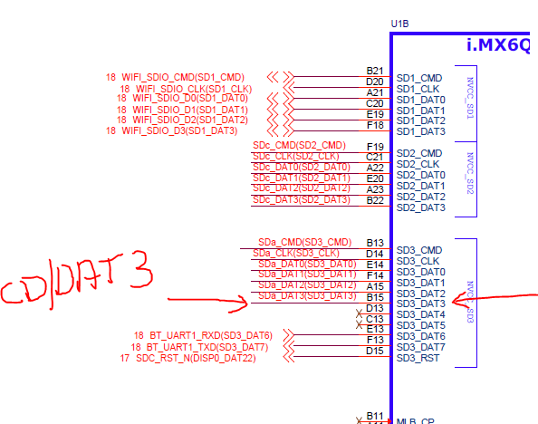

  2. Vdash SD Interference
    In our design, we are using micro SD card. In micro-SD “Card Detect” pin is multiplexed with DAT3 pin of SD card.
    REQUIRED CHANGES
    1. Card Detect function need to remove from the program, or set the SD3_DAT3 pin initially as Card detect and then as DATA3 of SD card interface.
    2. Set the SD interface program for single bit communication
    3. Confirm that GPIO_2 pin is in logic high state.
