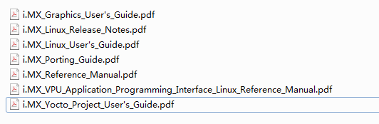

weidong_sun
Hello simon_willis,
See below, please!
Yes, it is no problem to use L5.4.24_2.1.0.
1. Downloading linux document.
https://www.nxp.com/design/software/embedded-software/i-mx-software/embedded-linux-for-i-mx-applicat...
--Supporting Information (42)
     ---- L5.4.24_2.1.0_LINUX_DOCS
