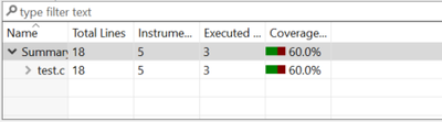

Try to open "gcda" and "gcno" files using gcov profiling tool. (Below screenshot attached for "evkmimxrt1170_hello_world_demo_cm7" this example code)
Also try to open "FRDM-K64F_gcov_bm" already generated "gcda" and "gcno" files. But It's showing "0%" coverage data.

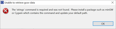

Hope you are well. I was able to replicate this issue and found the same issue. This message was displayed when trying to open the gcno file and the coverage results were displayed in 0´s like the picture you attached:
To solve this, I opened the command prompt and executed "strings -v".
After doing this, the coverage data was captured correctly.
Please let me know if this solves your problem, if you have more questions do not hesitate to ask me.

Make sure that MCUXpresso has the tool installed, otherwise, you have to install it.
It is also important to check that the corresponding binary utilities are on the IDE, you can refer to this post: https://mcuoneclipse.com/2017/06/18/adding-gnu-coverage-tools-to-eclipse/
Which message is displayed when you try to open the gcov files?

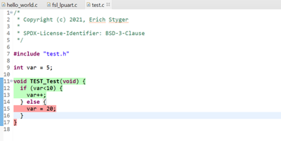

Rather than setting the gcov flags (-ftest-coverage -fprofile-arcs) for the whole project I have tried setting them for individual files.

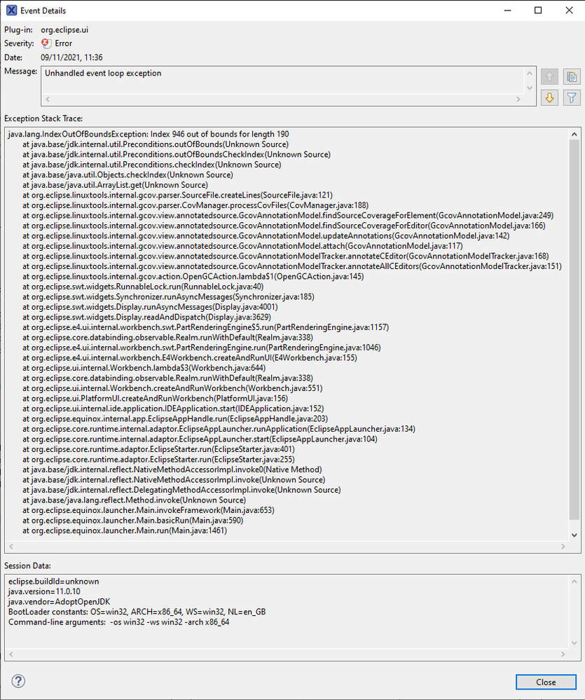

This resulted in a successful population of the coverage data for the selected files in the gcov view, however, when certain files are added it appears to cause the following error and this prevents and data being displayed. For example, board/board.c:
I have tried cutting bits out of this file (e.g. unused functions, #def'd code) but have not yet been able to determine what MCUXpresso/gcov does not like about it!

'gcov' tools is installed and for most files it works 'OK'(*), however, some files do cause the above 'Unhandled loop exception' error when the results are opened.
