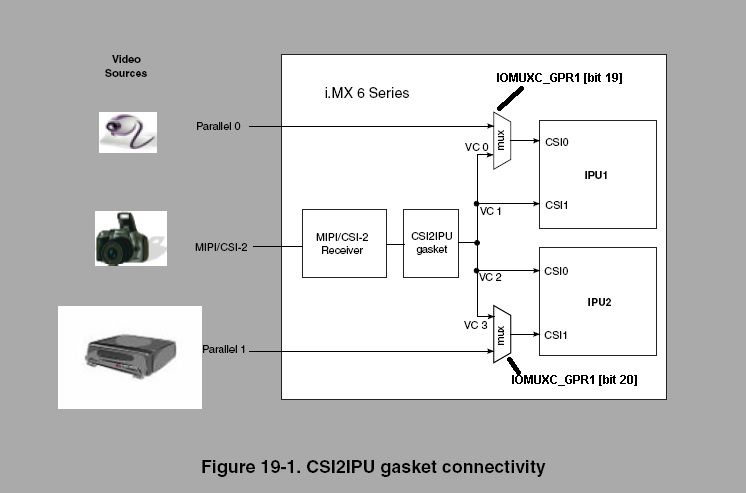

Dear all,
We would like to connect three cameras to i.MX6.
(CSI Parallel port 2ch + MIPI-CSI port 1ch)
According to i.MX 6 Series Firmware Guide, MIPI and parallel seem to be exclusive.
i.MX 6 Series Firmware Guide Rev.0:
- 21.5 IOMUX pin mapping
- Table 21-4. Camera interface mode setting
Can three ports be inputted simultaneously?
If so, Could you teach the value of Bit19-20 of IOMUXC_GPR1 register which should be set up?

Yuri
It is possible to connect three cams to i.MX6.
You may look at Figure 19-1 (CSI2IPU gasket connectivity) of the i.MX6 DQ Reference Manual.
