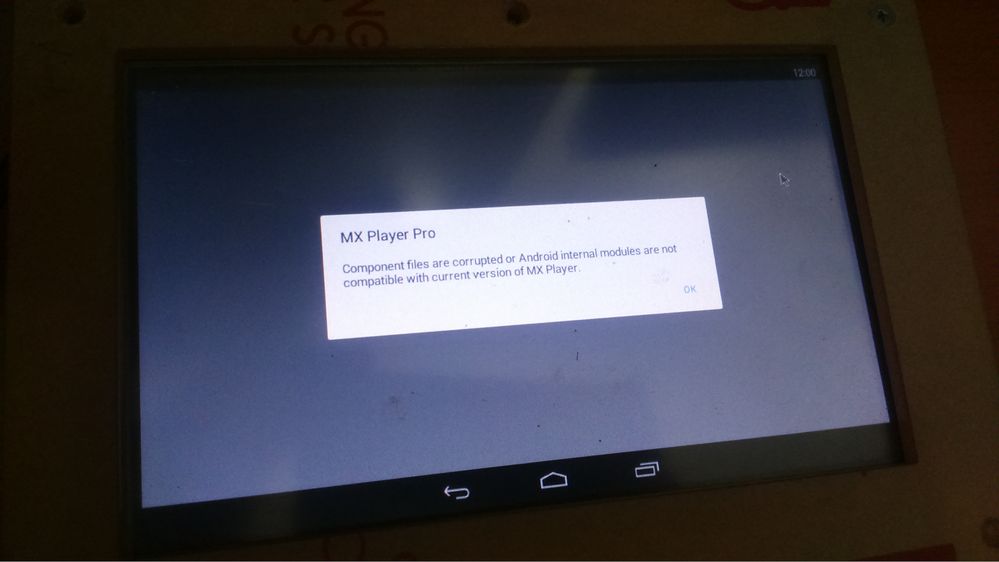

I am able to install the apk manually using pm install after the system boots up from the given link,
Download - MX Player
As told in the case of VLC player, facing error when I tried the MX player as  system app ( snapshot of the error in the board is attached)
Can you please let me know that how can I install the same as system application, like all other system apps( Gallery, Music, Browser etc)
Thanks in advance,
Ambika

After the above update, I installed manually installed the apk  and while manual installation got the below piece of lines from logcat
D/dalvikvm( 1244): Trying to load lib libjavacore.so 0x0
D/dalvikvm( 1244): Added shared lib libjavacore.so 0x0
D/dalvikvm( 1244): Trying to load lib libnativehelper.so 0x0
D/dalvikvm( 1244): Added shared lib libnativehelper.so 0x0
So have updated the Android.mk  as below,
LOCAL_PATH := $(call my-dir)
include $(CLEAR_VARS)
LOCAL_MODULE_TAGS := optional
LOCAL_MODULE := VLC
LOCAL_REQUIRED_MODULES := libjavacore.so \
  libnativehelper.so
LOCAL_CERTIFICATE := PRESIGNED
LOCAL_SRC_FILES := VLC.apk
LOCAL_MODULE_CLASS := APPS
LOCAL_MODULE_SUFFIX := .apk
include $(BUILD_PREBUILT)
LOCAL_MODULE := libjavacore
LOCAL_MODULE_CLASS := SHARED_LIBRARIES
LOCAL_MODULE_PATH := $(TARGET_OUT_SHARED_LIBRARIES)
LOCAL_SRC_FILES := $(LOCAL_MODULE).so
include $(PREBUILT_SHARED_LIBRARY)
LOCAL_MODULE := libnativehelper
But still facing the same issue.
Any solutions please???
