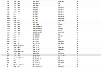

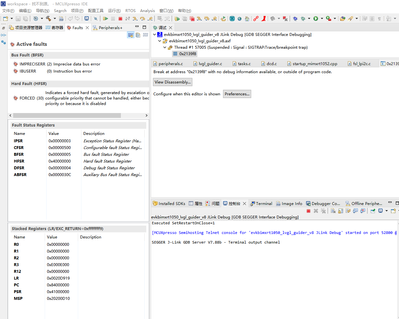

I replaced the original SDRAM with W9812G6KH. What should I do when I meet this problem.
481 Views
Omar_Anguiano
Hello
I hope you are well.
This issue might be related to the SDRAM parameters. I suggest you use SEMC example as reference to test your SDRAM. In that example, you will modify the parameters from your SDRAM datasheet.
