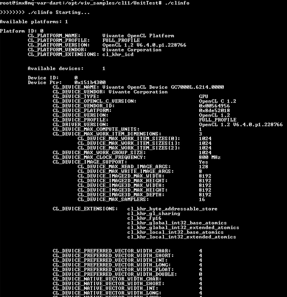

I'm trying to compare the performance of OpeCV algorithms on CPU and on GPU using OpenCL capabilities on the IMX8M.
The results I get using GPU (UMAT) are worse than on CPU(MAT).
I was checking the gputop and top tools while running and I saw some activity on GPU while running functions using GPU (UMAT), however, CPU was always between 95% to 100% on CPU and on GPU functions.

OpenCV in the i.MX Linux BSP uses the ARM NEON accelerators and not the GPU. That's why the CPU load is so high. I think when you force it to the GPU with UMat, then you get only little support by the GPU and the rest is done on the CPUs. If you work with Mat, then the CPUs and NEON are used - and this seems to be more efficient.

boris_sch1
I'm using yocto warrior-fsl-4.19.35-mx8mq-v1.0 from:
https://github.com/varigit/variscite-bsp-platform.git
My OpenCV version is 4.0.1
Here is the OpenCL info:
I don't have any patches for GPU.
GPU memory is 256MB.
Code example:
