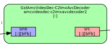

We are currently debugging the open-source video player QGroundControl( https://github.com/mavlink/qgroundcontrol ). We have switched the video decoding to hardware decoding, using the gstreamer element shown in the following figure:
Our final pipeline diagram is shown below:

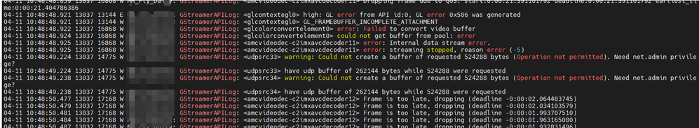

We tracked the logs of gstreamer (gst_debug_det_default_threshold (GST_LEVEL_EARNING); )When there is an error in the video playback resolution switch, the gstreamer log reports the following error:
My question:
How should I solve this problem? Should I optimize the parameters of some element? If so, which components should I optimize and what should be the direction of parameter optimization?

Hi @pyh0603
Sorry to reply late. Did you try the latest version code?
Could your please share your test process? Include your test code,  I will try to test it on my site.
