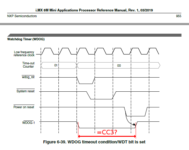

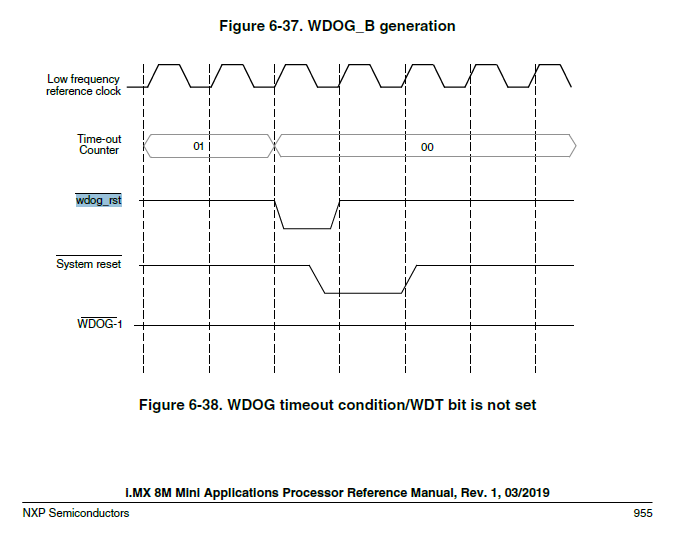

Hi all,
  • Does WDOGx_B shown in the i.MX8M-Mini data sheet mean the WDOG_B external output signal?
  • Or does it mean the wdog_rst internal signal shown in the reference manual?
We want to know the low width of the WDOG_B external output signal for our product design.
BR,
George

The external WDOG output signal  (similar as WDOG-1 on the picture)
is not controlled in software.
~Yuri.

  The CC3 parameters relates to external output signal:
"WDOGx_B output signals (for each one of the Watchdog modules) do not
have dedicated pins, but are muxed out through the IOMUX"

Dear Yuri,
Thank you for your reply.
  • Does CC3 parameter for external output signal you say mean red mark in the figure below
  • Can I make the low pulse width longer by Watchdog register settings?
  • Or is this length uncontollable by the user?
BR,
George
~Yuri.
