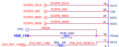

I'm working on getting the Infineon SLB9670 to work on the ECSPI2 bus of an IMX8MQ processor on the 4.19.35 kernel built using Yocto. The device seems to get detected on the bus ( there's a "spi1.0" node in the  /sys/bus/spi/devices directory), but for some reason, it is never associated with the TPM module and hence fails to come up as a TPM in the /dev directory.
After some printk debugging, I noticed that it fails to detect the valid bit being set on the TPM ( in wait_startup (tpm_tis_core)) and therefore doesn't initialize the device any further.
Probing the signals, I do see TPM replying with 00 01, but module fails to detect this. All the other pins seem to be behaving as expected, so this seems like a device tree or kernel problem.
I'm at a loss of what else to try and would appreciate any suggestions on how to get it to work.

Hi rohitdubey ,
It seems that TPM IC is in reset mode. You can check the datasheet and see that it requires a active high to work in normal mode. For this you need to add the pinmux for reset pin in the "pinctrl_ecspi2" with internal pull-up. Once the TPM is in normal mode it should come out of "wait_startup".

Thanks for your reply. We found the issue and it seemed to be related to the way nxp processors handle the SPI Chip Select GPIO lines. From the kernel documentation :
- cs-gpios : GPIOs to use as chip selects, see spi-bus.txt. While the native chip
select lines can be used, they appear to always generate a pulse between each
word of a transfer.  Most use cases will require GPIO based chip selects to
generate a valid transaction.‍‍‍‍
We declared the pin as a GPIO and it works as expected. For anyone else encountering the same issue, here's the working device tree entry:
