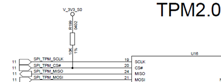

I am trying to enable a TPM 2.0 device (Infineon SLB9670XQ2.0)  which is connected to the ECSPI2 bus of an IMX8MQ processor, and when booting up the target board, I encountered an issue that the initialization of the TPM device failed with the below error messages:
tpm_tis_spi spi1.0: 2.0 TPM (device-id 0x1B, rev-id 16)
tpm tpm0: A TPM error (256) occurred attempting to generate an interrupt
tpm tpm0: [Firmware Bug]: TPM interrupt not working, polling instead
tpm tpm0: A TPM error (256) occurred continue selftest
tpm tpm0: starting up the TPM manually
tpm tpm0: tpm_transmit: tpm_recv: error -5
tpm tpm0: TPM self test failed
tpm_tis_spi: probe of spi1.0 failed with error -5
The TPM self test failed because the TPM device is not able to generate an interrupt. Display of kernel debugging messages shows that, prior to the TPM self test, the TPM driver failed to set the Global Interrupt Enable bit on the TPM Interrupt Enable register to 1.
To find out why the driver can’t write to a TPM register, we tried to monitor the SPI Slave Select GPIO pin on oscilloscope during the SPI data transfer (interrupt-driven PIO, not DMA) to/from the TPM device, we observed that the Slave Select pin can be pulled Low during data transfer and set to High when data transfer is completed, and therefore we believe the SS pin is not hindering the data transfer, and afterwards, when we proceed to monitor the SPI clock pin, we observed that there is no clock signal comes out from the pin at all, as a result, we suspect that the failure to write to a TPM register is due to no SPI clock signal to the TPM device during data transfer.
When investigating why there is no SPI clock signal generated for the TPM device, we noticed that the clock enable function tpm_tis_clkrun_enable()in the TPM TIS driver (kernel version 4.14.78) supports only LPC bus on Intel platform but not the ECSPI bus on NXP IMX8M platform. It looks like the current TPM TIS driver is missing the implementation to support the enable/disable of clock signals from ECSPI bus to the TPM device during data transfer. Below is the code of function tpm_tis_clkrun_enable(),

The schematic of IMX8M ECSPI2 pin interface:
 The schematic of TPM device interface to the IMX8M ECSPI2:
 The ECSPI2 configurations in the device tree file is as shown below:

These two lines were previously added to suppress the error message:
[   12.728854] spi_imx 30830000.ecspi: dma setup error -19, use pio
Besides that, I went through the MCIMX51RM document, and found the DATA CTL field in CONFIGREG, updated the SPI driver to make sure that the ECSPI2 (SPI 1 channel) is activated and set the inactive state of the MOSI line to stay Low.
13,253 Views
yuklin_soo
I want to take back my previous claim that there are no signals come out from the SCLK pin, after adjusting my oscilloscope bandwidth to full, I am now able to see the SPI clock signals sent to the TPM device.
Another thing I noticed is that, when data is transferred between the SPI master and the TPM slave device during the TPM driver initialization:
SPI MOSI - is set to HIGH and data bits sent through this line are superimposed on the 3.3V signal
SPI MISO - is set to LOW and data bits sent through this line properly
When initialization process completed and the SPI interface is idle,
SPI MOSI - is idle HIGH
SPI MISO - is idle LOW
The current issue is that the TPM driver is able to read from a TPM register (through MISO) and Not able to write to a TPM register (though MOSI). Therefore, it seems the problem is on the MOSI line, is it because the data is sent through a MOSI line which is always at logic level HIGH, and that is causing the TPM device to ignore the data sent?
