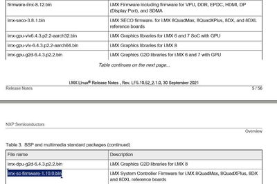

Dear igor,
Thanks a lot for your reply.
I had checked the release note, it seems our uboot version and linux kernel version is just the same as release note. For other binaries and firmware, I am not sure how to check whether they are imcompatible.
And I also read AN12631: Normal and Secure Debug for i.MX8/8X Family of Applications Processors – Application Note, but we don't have core dump file. We only have attached log file.
Please share your opinion.
Xiaojuan Qi.
8,820 Views
igorpadykov
from Linux 5.10.52_2.1.0  i.MX Linux Release Notes
From dump.zip "U-Boot 2018.03" was used (it should be used with Linux 4.14.98_2.3.0), it is very old
software and not more supported. May be suggested to use latest L5.x kernels described on
https://www.nxp.com/design/software/embedded-software/i-mx-software/embedded-linux-for-i-mx-applicat...
igor

xiaojuan_qi
Dear igor,
Linux 4.14.98_2.3.0 is just the linux version we are using.
I am not sure whether we can update to Linux 5.10.52_2.1.0.
Is there any other thing I can try based on Linux 4.14.98_2.3.0?
Thank you.
Xiaojuan Qi
8,805 Views
igorpadykov
unfortunately Linux 4.14.98_2.3.0 (and any software based on it) is not more supported,
support for outdated releases can be provided with  https://contact.nxp.com/new-prof-svcs-sw-tech
igor

Hi Xiaojuan
such error may happen due to incompatible revisions of software components
(they are described in Release Notes for each BSP on below link), for example scfw from one linux
release, uboot from other, rootfs binaries or other firmware binaries from some another third linux release
In general one can try to debug it to find exact place in codes where error happens using
For "Timeout for IPC response!" may be useful to check sect.10.3.2.1 RPC/IPC Reset Request sc_fw_api_qx_b0.pdf document included in SCFW Porting Kit​ 1.10.0
igor
