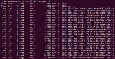

After bitbaking the optee-examples , the result was 100% succeed. But when I boot my machine and check the TA binaries in /lib/optee_armtz/ I don't see any interesting TA example for example the hello_world uuid .ta file which should be "8aaaf200-2450-11e4-abe2-0002a5d5c51b.ta"
And as you can see even after launching the xtest to install the ta file :
I really need help on that please , the question is that the correct way to build optee-examples  into IMX yocto project ? If it is , why I can't see the optee-examples .ta files ? Otherwise what should I do to fix this problem because I really need to develop my custom trusted apps in the future ?

IMPORTANT UPDATE :
I managed to solve the problem. My solution is to only add optee-examples_3.13.0.imx.bb file into the path meta-imx/meta-bsp/recipes-security/optee-imx/  .

Notice that I used in purpose "IMAGE_INSTALL_append" and not "IMAGE_INSTALL +=" . I passed long time to conclude that with the "IMAGE_INSTALL +="  I don't manage to see my binaries into rootfs of the image but with the append syntax that works correctly. I don't know for what reason is that. But with this way it worked perfectly. According to bitbake documentation that's equivalent but if you have any idea why is that don't hesitate to share it with us.
