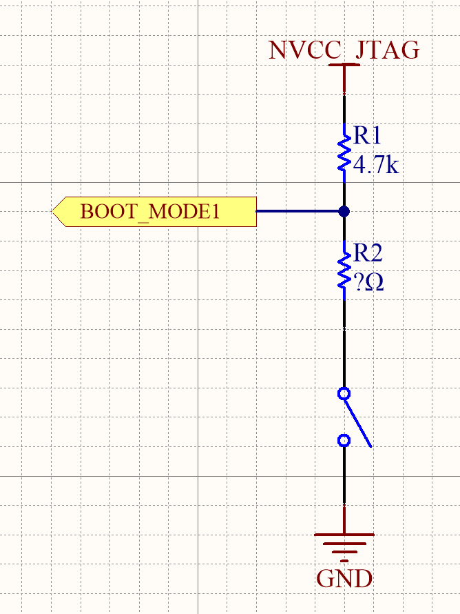

I know the recommendation is to normally use resistors, but I've got an application where I'm looking to temporarily override what the pin is pulled to. For example, if I normally have BOOT_MODE1 set to 0 by pulling it down to GND through a 100k resistor, I'm looking to temporarily set it to 1 by connecting the pin to NVCC_JTAG.

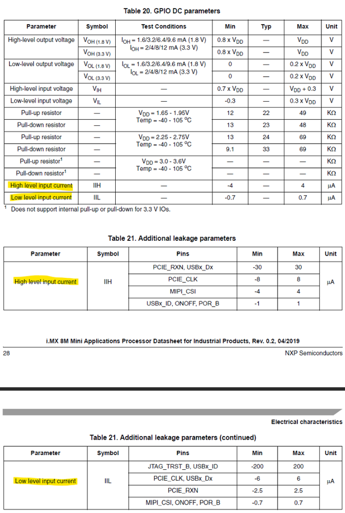

Will the leakage through the pins be limited to the leakage parameters listed in Table 20 and 21 of the i.MX 8M Mini Datasheet?

igorpadykov
Hi adevries
not. Unfortunately they are not specified.

That is very good to know. Since there must be a resistor to control the leakage, current, could you recommend what value resistor I should use?
In the image below, I have BOOT_MODE1 pulled high to NVCC_JTAG with a 4.7k resistor. I'm looking to temporarily override that and pull it low with a stronger resistor. What value would you recommend?

igorpadykov
Hi adevries
general recommendation is to follow nxp i.MX8MMini reference schematic
i.MX 8M Mini Evaluation Kit LPDDR4 Design Files
and
i.MX 8M Mini Hardware Developer’s Guide
p.14 SPF-31407 BaseBoard schematic gives similar example for overriding boot resistors.
igor

adevries
Contributor V
Hi Igor,
Okay, thanks for the recommendation. I'll adjust my design to more closely follow the baseboard schematic.
