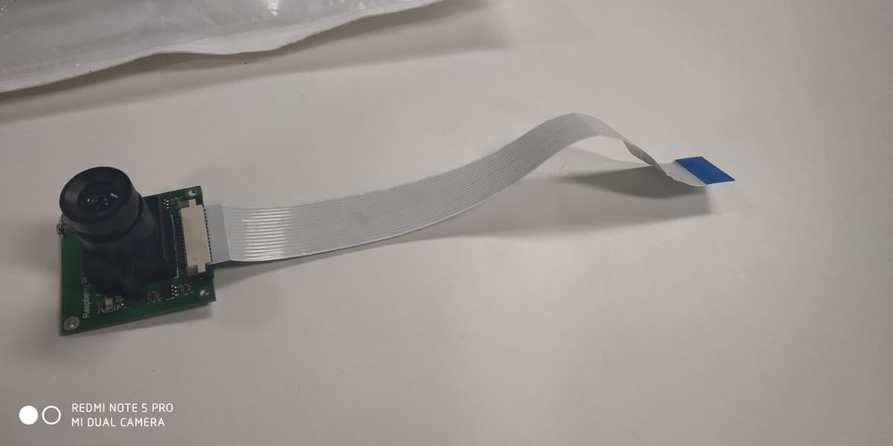

I am working IMX6Q with Android Nought. I want to interface the camera with my Custom board. I have 15 pin camera connector. I want the compatible camera for this camera connector.
Now I am using OV5647 (15 pin camera connector). Please check the image.
But, Customer needs advanced one with compatible one.
Please suggest the good camera with 15 pin camera connector.

Hi vinothkumar,
    Unfortunately, it is very hard to find a camera module for customer's connector, Because each manufacturer's camera module interface definition is different, even if they use the same image sensor.
    Usually, we need to select a camera module and design a adapter board to connect the camera to CPU board.
In addition, I have to clarify that there is no ISP module in i.MX6, customer can use GENERAL MODE to capture ov5647 image, but mxc_v4l2_capture driver didn't handle raw data. so the better choice for customer is to select a camera module with ISP function.

Hi vinothkumar,
    I don't know if you have understood my meaning. Many camera modules are based on OV5645/OV5640 Chipset, and signal definitions of these camera modules are different.
    Before starting your design, you should firstly select a type of camera module, then select connectors according to it's datasheet, and define signals on the connector (according to datasheet). BUT now you defined signals on a connector on board by yourself, then you want to find a camera module to match your connector and signal definitions. This is almost impossible to accomplish.
    So now you should select a camera module from provider, then according to it's datasheet, check if an adapter board is needed, if yes, please design one for your camera module!
