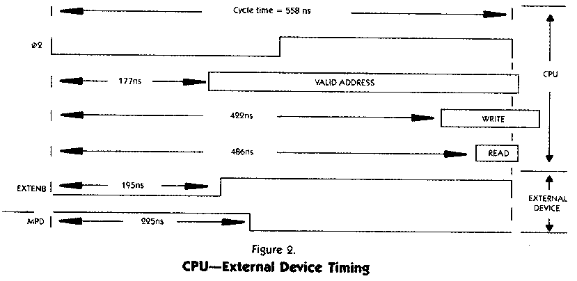

I'm looking to figure out whether I can get use an i.MX1176 to solve a tight-timing problem in software when reading a bus rather than resorting to an FPGA. Here's the bus timing
It's a 6502, so there's also the voltage-level-changing delays to concern me, but the main problem is the bottom trace (/MPD). I have to read the address lines, do a lookup in a 256-long table of A[15:8] and if the entry in that table is '1' rather than 0, assert /MPD, else ignore it and let it keep floating high.
The timing budget for this is ~45ns, given that A being active at 177ns from the clock-cycle probably translates to 180ns from the clock falling.
My plan was to use the M4 to poll the bus, dedicating it to the task of handling the bus signals, then M4 writes to shared memory, pings a semaphore, and lets the M7 actually process stuff. That is predicated on the delay to assert a GPIO being sufficiently rapid, but looking at this gave me some hope that would be possible - 10ns to toggle a GPIO is awesome.

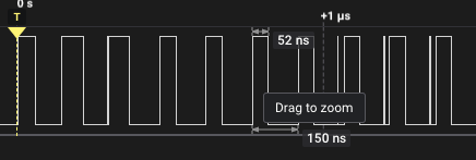

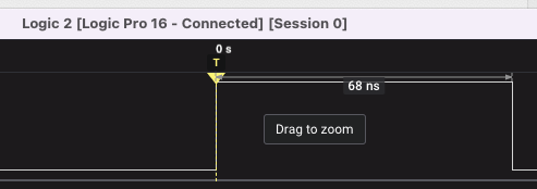

Sadly, I'm not seeing that using my board. I've set the build to 'Release' and set it so that GPIO9(io 6) is the GPIO being toggled, set the slew rate to be fast...

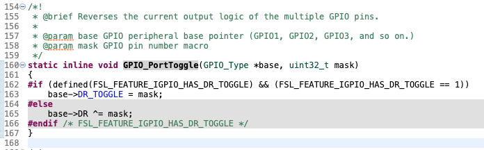

and I'm calling:
        PRINTF("Toggling.\r\n");
        GPIO_PortToggle(GPIO9, 1<<6);
From looking at the library code, it seems to be doing the correct thing, assuming the inline is honored for a release build (in fact I checked this, and replaced the function calls to the direct register-set operations)...
But I'm only getting a 68ns period not a 10ns period like in the linked article...
I'm totally new to the i.mx series, I'm presumably doing something stupid, so if anyone has words of wisdom, I'm all ears...

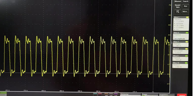

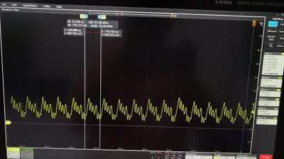

  Please test my project on the MIMXRT1170-EVK board, the test GPIO pin is the  GPIO_AD_04, J9_8pin.
  Use the fast GPIO, it should can upto 248.87MHz, sine wave. normal GPIO also can upto 17.12Mhz, pulse wave.
  My oscilloscope sample rate is not enough, so to the fast GPIO, the wave is not good.I just get 81Mhz, as my testing tool is not enough, sample rate just 1GS/s.
  But our AE can get 248.87Mhz sine wave, you also can test it on your side.
  We suggest you use the oscilloscope with 2GHz bandwidth, sample rate to 10Gs/s, then I think you can get the AE related data.
I attach my project, you can test it directly, as it is calling the fast GPIO directly, testing pin is the J9_8.
You can see my wave:
Normal GPIO 17.22Mhz, I can get it correct:
But to the fast GPIO, my oscillator is not enough, just up to 81M
But, I can make sure, if the oscillator is 10Gs/s sample rate, you can get 248.87Mhz sine wave.amplitude is 1/4 sine wave.

Hi @simongornall ,
  I am really so sorry for my later reply, as really overwhelming in the case testing.
  I checked your situation, your low speed 54ns should from the normal GPIO, not the HSGPIO.
   If you use the HSGPIO, then you will get the higher gpio frequency, The HSGPIO even can get the 248.87Mhz when M7_CLK=996Mhz, BUS_CLK=240Mhz, I/O PAD is fast slew, use the GPIO->DR_TOGGLE.
  I will test it today, and give you my project and the wave pictures, wait me a moment.
Kerry

simongornall
Hi Kerry, thanks for getting back to me
So the code I'm using is very similar, though I was using GPIO9 bit 6 instead. There are a couple of differences....
The auto-generated code from MCUExpresso creates:
  IOMUXC_SetPinConfig(
      IOMUXC_GPIO_AD_07_GPIO9_IO06,           /* GPIO_AD_07 PAD functional properties : */
      0x07U);                                 /* Slew Rate Field: Fast Slew Rate
                                                 Drive Strength Field: high drive strength
                                                 Pull / Keep Select Field: Pull Enable
                                                 Pull Up / Down Config. Field: Weak pull down
                                                 Open Drain Field: Disabled
                                                 Domain write protection: Both cores are allowed
                                                 Domain write protection lock: Neither of DWP bits is locked */

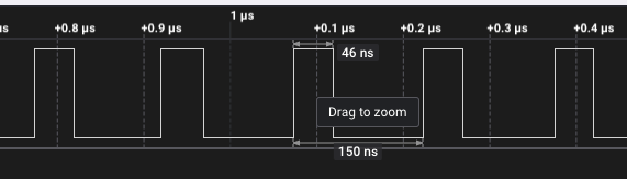

Looking in the 1170 reference manual, page 1096, 0x07U would correspond to:
  • Slew rate slow (at odds with the comment)
  • Drive strength high
  • Pull enabled
  • Weak pull down
  • Open drain disabled
  • Both cores allowed
  • Neither DWP bit locked
Whereas the blog code uses 0x0EU which sets a weak pull-up (instead of pull-down) and sets the slew rate correctly. I ought to be using 0x06 to set the slew rate, which would seem to be a bug in the IDE (since I set slew rate to fast in the "pins" tool of the IDE, and the comment makes it look like it's supposed to have bit 0 set to 0.
Setting the slew rate correctly gives me pulses approximately 44 -> 54ns in duration, so that's helped, but it's still a long way short of 10ns.

However, I'm still seeing 52 -> 54ns pulses on the logic analyzer:

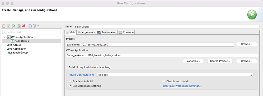

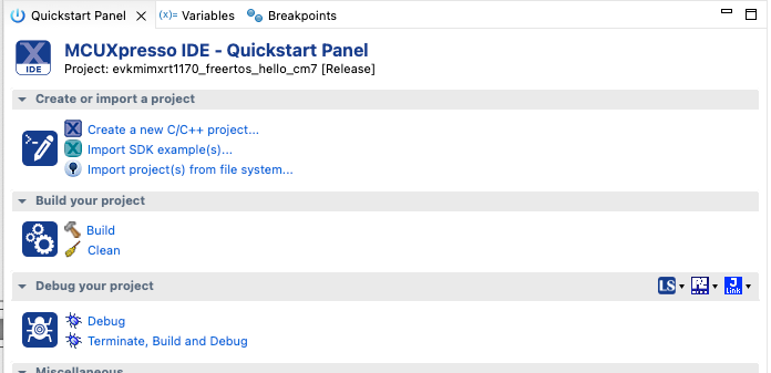

I am running using the 'Debug' operation of the Quickstart panel (with a release build).
Could the "debug" facility be slowing things down ? Is there a better way to run the application ? The green 'play' icon at the top doesn't seem to have anything that will let me configure a download-to-the-board-and-run operation, and nothing happens when I press it anyway ...
