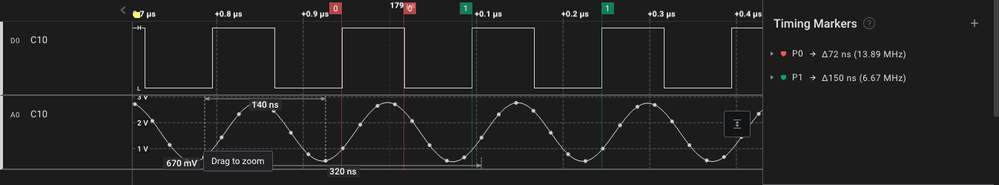

  I checked your situation, your low speed 54ns should from the normal GPIO, not the HSGPIO.
   If you use the HSGPIO, then you will get the higher gpio frequency, The HSGPIO even can get the 248.87Mhz when M7_CLK=996Mhz, BUS_CLK=240Mhz, I/O PAD is fast slew, use the GPIO->DR_TOGGLE.
  I will test it today, and give you my project and the wave pictures, wait me a moment.
Kerry

So the code I'm using is very similar, though I was using GPIO9 bit 6 instead. There are a couple of differences....
The auto-generated code from MCUExpresso creates:
  IOMUXC_SetPinConfig(
      IOMUXC_GPIO_AD_07_GPIO9_IO06,           /* GPIO_AD_07 PAD functional properties : */
      0x07U);                                 /* Slew Rate Field: Fast Slew Rate
                                                 Drive Strength Field: high drive strength
                                                 Pull / Keep Select Field: Pull Enable
                                                 Pull Up / Down Config. Field: Weak pull down
                                                 Open Drain Field: Disabled
                                                 Domain write protection: Both cores are allowed
                                                 Domain write protection lock: Neither of DWP bits is locked */
Looking in the 1170 reference manual, page 1096, 0x07U would correspond to:
  • Slew rate slow (at odds with the comment)
  • Drive strength high
  • Pull enabled
  • Weak pull down
  • Open drain disabled
  • Both cores allowed
  • Neither DWP bit locked
Whereas the blog code uses 0x0EU which sets a weak pull-up (instead of pull-down) and sets the slew rate correctly. I ought to be using 0x06 to set the slew rate, which would seem to be a bug in the IDE (since I set slew rate to fast in the "pins" tool of the IDE, and the comment makes it look like it's supposed to have bit 0 set to 0.
Setting the slew rate correctly gives me pulses approximately 44 -> 54ns in duration, so that's helped, but it's still a long way short of 10ns.

However, I'm still seeing 52 -> 54ns pulses on the logic analyzer:
I am running using the 'Debug' operation of the Quickstart panel (with a release build).
Could the "debug" facility be slowing things down ? Is there a better way to run the application ? The green 'play' icon at the top doesn't seem to have anything that will let me configure a download-to-the-board-and-run operation, and nothing happens when I press it anyway ...
