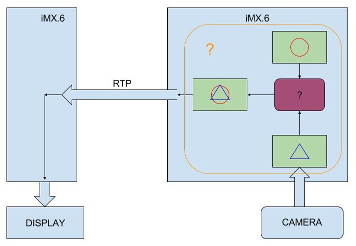

I am trying to implement a system that takes live camera stream, overlays some text and symbols (using Alpha-Channel transparency); and transmits it over RTP/UDP, as a single video (from one port). Both host and client systems have i.MX6QP on. For now, I am trying to figure out the GStreamer and pipeline system with gst-launch, and only using test patterns as video sources.
Here is a simplified diagram to show what I'm trying to achieve:
I have seen the videomixer plugin, but from what I understand, it is only used for overlaying and playing videos, not for creating 'transmittable' video streams. (I can use it with xvimagesink, but I couldn't achieve to implement the pipeline with udpsink. And I couldn't find a workaround for it.)
I haven't been able to find right tools/methods to implement the system described above. Am I right about the videomixer plugin? If so, what do you suggest me to do? Any help is appreciated, thanks in advance.

 You may look at section 7 (Multimedia) of “i.MX_Linux_User's_Guide.pdf”
regarding supported GStreamer features: in particular section 7.3.15 (Video
composition) may help.
http://www.nxp.com/webapp/Download?colCode=L4.1.15_2.1.0_LINUX_DOCS&Parent_nodeId=133769948107170617...

Thank you so much for the guidance. Unfortunately, I have no access to my setup for a week, so I am not able to try example pipelines with imxcompositor_g2d.
So you say that I can direct the composed video (created using imxcompositor_g2d) to the ethernet line? The first example in the document you've shown is this:
gst-launch-1.0 imxcompositor_{xxx} name=comp sink_1::xpos=160 sink_1::ypos=120 ! overlaysink videotestsrc ! comp.sink_0 videotestsrc ! comp.sink_1
If I modify the pipeline like below, would it work?
gst-launch-1.0 imxcompositor_{xxx} name=comp sink_1::xpos=160 sink_1::ypos=120 ! udpsink host=19.10.1.22 port=5000 videotestsrc ! comp.sink_0 videotestsrc ! comp.sink_1
Like I said, I cannot try it for now, but I did some tryings with another plugin, named imxg2dcompositor, with similar pipeline structure and couldn't achieve to receive properly.

  This is advantage of Gstreamer using, that we can just insert needed (proper) element in pipeline
to get required functionality.
