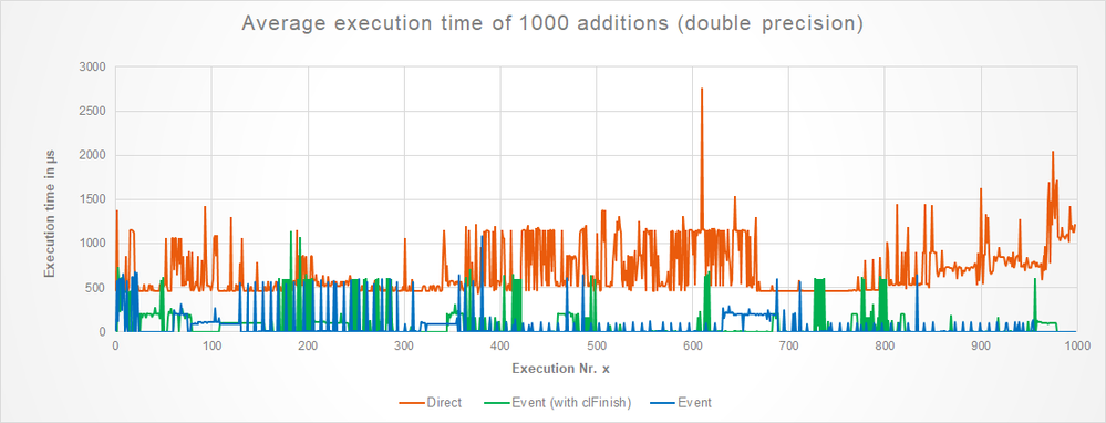

peter_eberl
Bio_TICFSL‌
The graph shows the kernel execution times of a simple vector-vector additions with vector size 1000.
The addition was executed 1000 times.
My problem is the variance of values:
Min. exec. time:  2E-6 seconds
Max exec. time:  9.61E-4 seconds
Median:              9E-5 seconds
Even with 10E4 executions the max exec. times vary to around 2ms.
Execution Values are extracted through clGetEventProfilingInf() method (end-start timestamps).
Questions:
What causes this extreme variance of ~500%?
Is yocto linux a real-time operation system? -> Are possibly interrupts a cause of delay of enqueueing?
Am i measuring the timestamps correctly?
3,521件の閲覧回数
Bio_TICFSL
Are you changing any of the arguments passed to cl kernel for each kernel execution? are the kernel parameters the same?
what do you get if not using wait for event when running the cl kernel like this:
 gettimeofday(&start, NULL);
  ret = clEnqueueNDRangeKernel (cq, kernel, dimension, NULL, global, local, 0, NULL, NULL);
  if  (ret == CL_SUCCESS)
   printf( "\nReading data from GPU memory = ..\n");
  }else
   printf( "\nKernel failed = ..\n");
  // Should be the barrier here?
  clFinish(cq);
gettimeofday(&end, NULL);
  //compute and print the elapsed time in millisec - For writting data into input buffer
  seconds  = end.tv_sec  - start.tv_sec;
  useconds = end.tv_usec - start.tv_usec;
  mtime = ((seconds) * 1000 + useconds/1000.0) + 0.5;
  printf( "\n CL code = %ld ms\n", mtime);
