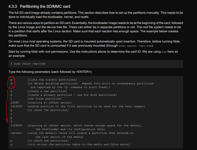

The following figure:when I type the  sudo fdisk /dev/sdx, and then type 'p',next type 'd',But when I keep typing d,Linux gave me the same tip.In that case, how am I going to finish p -d -n -p -l -20480...-w
Or I can't read the Linux prompts.
So I can't go back to the document.

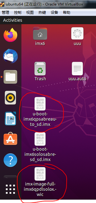

I burn :
I don't know if I burned it right

Hello guojpf,
You need to download to SDCARD, you are doing the procedure to HDD, the Sdcard should be /dev/sda or sdx, the rest of image creation is ok.

So what should I do in section 4.3.3? Follow the document step by step but it doesn't work。 Am I typing instructions from the document?

Yes it works but it refer to sdX where the X is the label that your operating system get to SDCARD in this case should be sda or sdb.

guojqf
I'm going to use the following command to get sdX,but I don't know which file to flash.
for example,my board is IMX6 SX-SABRE SDB,I don`t know which image I should flash to the board,

  1. u-boot-imx6sxsabresd_sd.imx
  2. u-boot-imx6sxsabresd_sd-optee.imx
  3. u-boot-imx6solosabresd_sd.imx
  4. u-boot-imx6solosabresd_sd-optee.imx
I want to boot from my SD card
thanks
