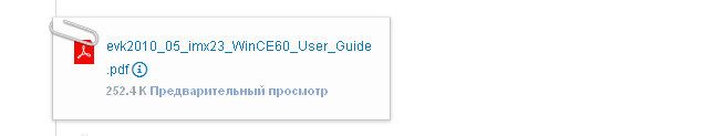

Hi kishore
in eboot one can download images to NAND with PB help, please
refer to attached WinCE Guide sect.5.5 Configuring USB Serial Connection
for Downloading and Debugging, sect.5.3.2 Burn EBOOT onto NAND flash using PB.
Otherwise one can use MFG Tools.

igorpadykov
Hi Kishore
it is attached in answer from
in general one can use eboot sources and write own custom application
for nand image update through usb.
