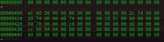

I am having trouble with the getting the signed SPL running. The errors tell me that the DCD data is not signed properly.
My SPL image hexdump is follows:
Can you please check your hexdump and tell me if its similar. Also do you know where SPL's DCD information which is used to initialize the RAM is present?
Thanks & Greets,
Satya

Unfortunately, right now I'm using the old fashioned one file u-boot. I know for sure that the DCD pointer is located in the offset 12 of the IVI structure (one file u-boot):
od -x -N 48 u-boot.imx
0000000 00d1 4020 0000 8780 0000 0000 f42c 877f
0000020 f420 877f f400 877f a000 8788 0000 0000
0000040 f000 877f f000 0008 0000 0000 01d2 40e8
0000060
Offset
Name
Value
0vt.header0x402000d1
4ivt.entry 0x87800000
8ivt.reserved1 0x00000000
12ivt.dcd_ptr 0x877ff42c
16ivt.boot_data_ptr0x877f420
20ivt.self0x877ff400
24ivt.csf 0x8788000a
28ivt.reserved2 0x00000000
32boot_data.start 0x877ff000
36boot_data.size 0x0008f000
In fact, I tested the U-Boot is case of signing and encrypting - it works.

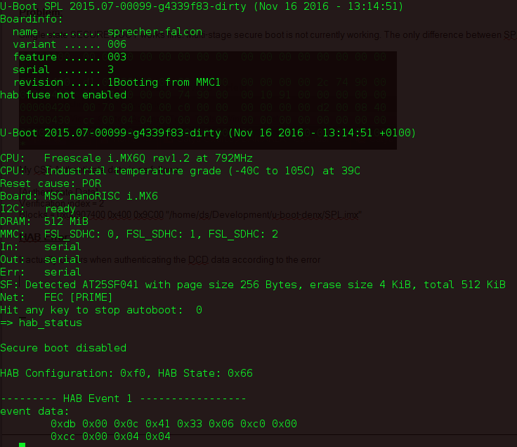

satyadamarla
Hi Robert,
My HAB erros for SPL is as follows:
The meaning of the error code is as follows:
0x33 - HAB failure
0x06 - Invalid Command
0xC0 - Executing DCD or CSF
0x00 - Engine
0xcc 0x00 0x04 0x04 - This hex stuff is the command that has to be executed "cc 00 04 04".
0xcc - Write Data
0x00 & 0x04 is the length which is 4 bytes
0x04 - parameter which means the address is 32 bit value.
The CSF Authenticate is as follows
[Header]
Version = 4.0
Hash Algorithm = sha256
Engine = ANY
Engine Configuration = 0
Certificate Format = X509
Signature Format = CMS
[Install SRK]
File = "../crts/SRK_1_2_3_4_table.bin"
Source Index = 0
[Install CSFK]
File = "../crts/CSF1_1_sha256_3072_65537_v3_usr_crt.pem"
[Authenticate CSF]
[Install Key]
Verification index = 0
Target Index = 2
File = "../crts/IMG1_1_sha256_3072_65537_v3_usr_crt.pem"
[Authenticate Data]
Verification index = 2
Blocks = 0x00907400 0x400 0x9C00 "../u-boot-denx/SPL.imx"
The values with V=1 in make matches with my CSF values. The error is with DCD data. In my case it is kinda empty, not really empty but only 4 bytes in length. On the other hand my single stage booting works well in SECURE_BOOT.
I hope the ENGINE=Any is not a problem. Can you get any info from the error messages?
