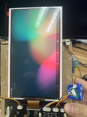

I'd like to seek assistance regarding a screen auto-rotation issue I encountered while attempting to port the ICM-20948 IMU sensor on Android 11.
Hardware and Software Details:
  • CPU: i.MX8MQ
  • Operating System: Android 11
  • IMU Sensor: ICM-20948

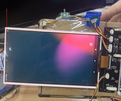

Description of the Issue: I've been working on adding support for the ICM-20948 IMU sensor in Android to enable screen auto-rotation. However, I've encountered a problem where the screen rotation is consistently off by 90 degrees.
Any assistance or guidance on resolving this issue would be greatly appreciated. If there are any specific areas of concern or details required, please let me know. Thank you in advance for your help.

hank2024
The problem has already been solved, and it is recorded here that you need to modify the Android HAL layer yourself and adjust the IMU direction.

The main issue is that when rotating the screen, it rotates an extra 90 degrees counterclockwise.
