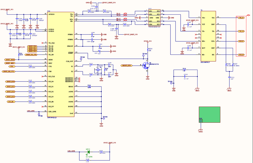

I am using a DP83848 TI chipset for ethernet and not able to detect the chip, Can any one help me how to read the registers using MDIO line in I.MX8MMINI

There is MII read uboot commands to read the MDIO lines.
i am able to read for the NXP EVK but  for our board with DP83848 TI Ethernet Phy we are getting "NULL device name!".

please find the below trace for the Same commands for DP83848 TI Ethernet Phy
u-boot=> mii read 0-1 0-6
NULL device name!
No such device: <NULL>
Error reading from the PHY addr=00 reg=00
NULL device name!
Error reading from the PHY addr=00 reg=01
NULL device name!
u-boot=> mdio read 0 00
0 is not a known ethernet
No such device:
Reading from bus
PHY at address 0:
u-boot=> mii info
NULL device name!
NULL device name!
----------------------------------------------------------l
Can we use mii and mdio read / write commands to access the Ethernet Phy register independently irrespectively to MII/RMII mode hardware configuration.?
Please advice how to proceed ahead

igorpadykov
Hi Santhosh
one can look at dp83848 phy uboot driver and debug on function dp83848_startup()
