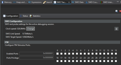

Configuration:
  • Main Clock speed: 528MH (#define BOARD_BOOTCLOCKRUN_CORE_CLOCK 528000000U)
  • Trace clock speed: 108MHz (#define BOARD_BOOTCLOCKRUN_TRACE_CLK_ROOT 108000000UL)
With this configuration, i am not using autodetect and set the Trace clock of 108MHz manually :
pierre_denis_0-1685007653733.pngpierre_denis_0-1685007653733.pngpierre_denis_1-1685007673905.pngpierre_denis_1-1685007673905.png
Configuration of the SWO:

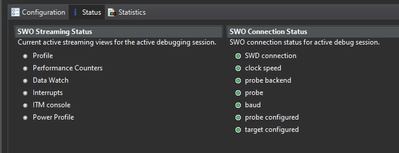

Widgets working:
Basically all except SWO Datas so SWO Profile/Interrupts/Timer/Console is OK.

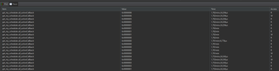

Widget which is not working:
SWO Data plot is quite buggy.
  • It is impossible to resize the plot and autosizing obviously does not work perfectly (see after)
  • we can't erase previous set of data between 2 runs
  • datas between plot and table tabs does not match (see after)
  • update frequency of the data should be quite slow for proper data update
Plot stay at 0
While table is indicating value changed:
This bug does not happen on all data. In this example, i am monitoring a variable inside a structure. gst_my_scheduler is a pointer to the structure. Another variable from the same structure does not seem to have any issue while it is the same kind of variable (uint32_t). What is suprising is that the table does display correct data, it is really the plot that is not displaying proper data values.
Is there specific limitation on some implementation (like volatile variable or packed struct)?
Is anybody out there does have the same issue? Is there some extra configuration to be done.
Thanks in advance

Here is a list of my issues
  • graph size when changing SWO data widget size (refer to capture on first post) don't resize in a correct manner.
  • some variable between table and plot are not the same (see captures on my first post) - table is good, plot is bad basically
  • if program is running constantly and we pause from time to time to modify data watched and run, after a certain number of occurence, IDE is freezing...
Other captures for the differences between table and plot. Signal is basically a ramp up from 0 to 4 and data is updated every 1ms.It is basically as the plot is undersampling my signal compare to the table. Sometimes 0 and 1 is not displayed, sometimes it is 4 even if everything is correct on the table.
Question related to my issues
  • Are there limitation on SWO Data watch (packed struct of volatile variable)?
  • Is there a way to force resizing of the plot?
  • How can we explain difference data between table and plot, how can we improve this to avoid losing precious values?
