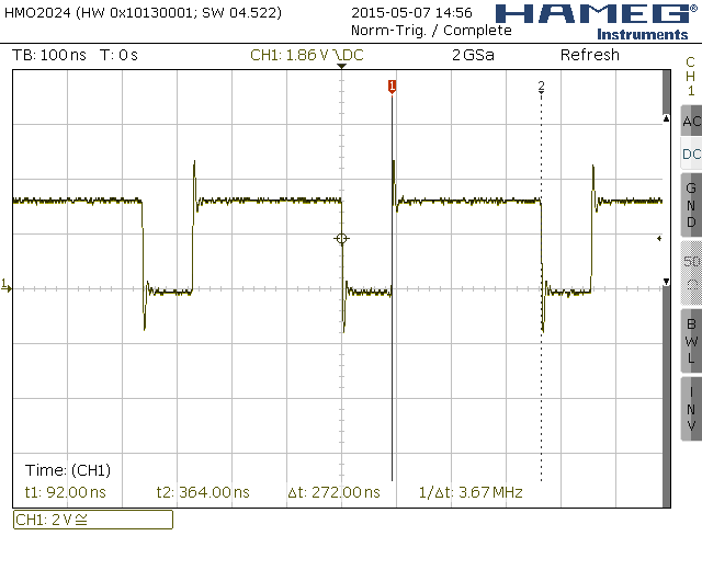

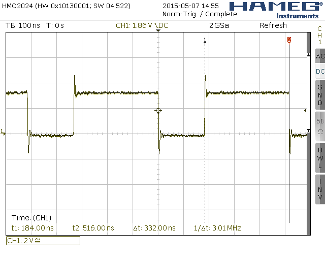

Using iMX6S, we are interfacing a 16bits parallel 45ns asynchronous SRAM, and the only way to have consecutive accesses without dead time is to widen the bus.
EIM bus registers :
EIM_CS1GCR1 00010001
EIM_CS1GCR2 00000000
EIM_CS1RCR1 03000000
EIM_CS1RCR2 00000008
EIM_CS1WCR1 03000000
EIM_CS1WCR2 00000000
I explain :
With a 16 bits configuration : reading or Writing 2 different words of 16 bits, imply to wait for about 250/280ns between the 2 accesses.
In the following pictures, we observe CS signal.
With a 32 bits configuration : reading 2 different words of 16 bits, through 2 consecutive accesses doesn't any dead time (90ns time  = 2 very consecutive access of our 45ns SRAM)  , but than we have to wait again for about 270ns between the 2 words of 32 bits.
With a 64 bits configuration: writing 1 words of 64bits = 4x 16bits word, through 4 consecutive accesses doesn't any dead time (180ns = 4x45ns) , but then we have to wait again for about 332ns for next 64 bits word Write
We are wondering if it is due to internal bus Exchange into the iMx6 which could explain this pain.
