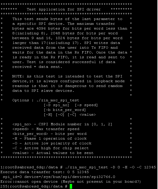

We try to running SPI unit test by external/linux-test/test/mxc_spi_test/mxc_spi_test1.c and use /sys/bus/spi/devices/spi32766.0 as SPI device node. But error report as below. May we know the correct SPI device node for this unit test under Android 4.4.3?
