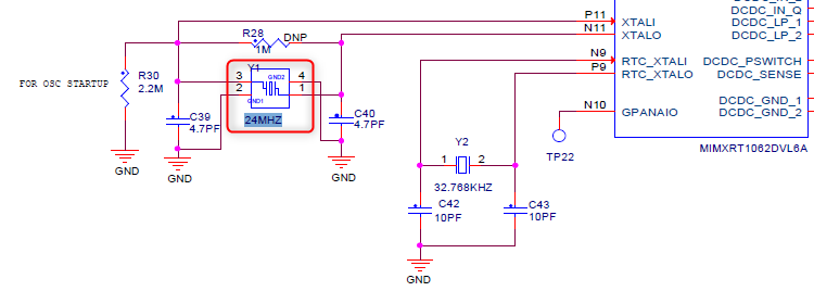

yoshida_satoru
Thanks Gavin.
I have a question about the 7V240000002 crystal.
Is 7V240000002 correct as the one in the red box in the screenshot below?
(The screenshot below is an excerpt from the RT1060 EVK circuit diagram)2024-12-09_09h01_16.png
2,855件の閲覧回数
Gavin_Jia
Hi @yoshida_satoru ,
Yes, it is.
