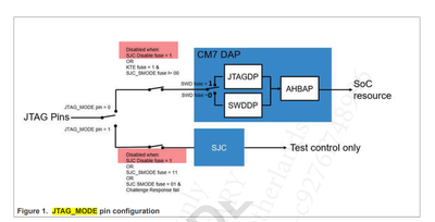

When blowing the SJC_FUSE on an i.MX RT1060 two things seems to happen:
  1. The debug session I have open over SWD with an MCU-Link connected seems to stop working immediately
  2. I'm unable to start new debug sessions or perform other actions towards the MCU using the MCU-LINK and SWD
While this is OK, I'm wondering if disabling the JTAG interface on the MCU also disables any SWD interactions?

Hi @dafela ,
Please kindly refer to this pic:
SJC_DISABLE negates both lines, so both are blocked. Either JTAG/SWD or even test control.
Bests,
Gavin

Hi @Gavin_Jia,
Thanks for confirming!
Out of curiosity, where is this picture from?

Hi @dafela ,
It is from AN12419: Secure JTAG for i.MXRT10xx.
ANs related to security features now require an NDA and a permission request to access them.
Gavin
