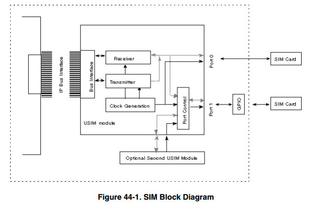

I am bit confuse about SIM interface on iMX6UL.
As per technical reference manual page # 2799, "The SIM module has one port that can be used to interface with the various cards."  But block diagram shows two port, 0 & 1.
Referred i.MX6UL pin muxing, Found that there are four ports.
SIM1.Port0,
SIM1.Port1,
SIM2.Port0,
SIM2.Port1.
Will appreciate any help or clarification for understanding above with reference if any.
Can you please let me know on which two SIM ports i can connect smart card? As datasheet shows upto 2 SIM interface support.

  Each SIM module can be connected to two separate devices via Port0 and Port1,
however communication to two devices from a single SIM module is alternate and
can not provide simultaneous communication. Please refer to SIM Setup Register
how to configure ports.
