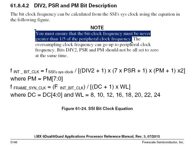

igorpadykov
even clocks are generated externally it makes sense to check SSI_CLK_ROOT
as there are dependencies :
~igor
5,178 次查看
benoitmoffet
Hi Igor,
Our ratio is good...
