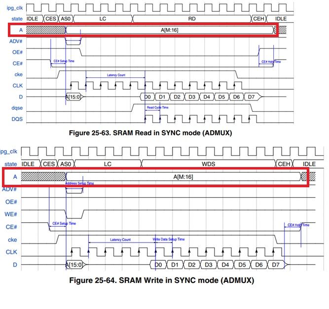

For the SRAM write/read in SYNC mode (ADMUX), just wonder is it possible to mask the higher address bit, A[M : 16], means not to use and free up my address pin, so that I can connect them extra GPIOs.
My SRAM application only need A0-15.

Yes, it is possible to use upper address pins (A16 and higher) as GPIOs when
SEMC operates in SRAM mode. Just configure these pins as GPIOs in IOMUXC.
Artur

Can the software call function/register support on masking or is the software/register adjustable? For masking the higher address bit, A[M : 16], while using SRAM write/read in SYNC mode (ADMUX) . Thank you.
