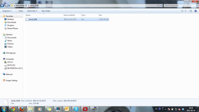

I see, I tried redownloading it and such, however I don't seem to be able to run this program... It just shows up as a file on my computer and not as an application. 132-Untitled1.jpg
Vladan Jovanovic said:
Yes, just give it a try. Insert uSD card to USB/SD reader and choose the right disk from the flasher app.
Carl Igelström said:
Does this flasher work on Windows 7 ?..?
You have entered some wrong lines there, as there's weird variables defines (VGA, SEIKO, botargs_base, console_base...).
Use the flasher binary for windows from HERE to re-program the uSD card you have. After that, just typing following should create setup that you need:

I see, I tried redownloading it and such, however I don't seem to be able to run this program... It just shows up as a file on my computer and not as an application. 134-Untitled1.jpg
setenv bootargs_base 'setenv bootargs console=ttymxc0,115200 gpu_nommu ${lcd}'
