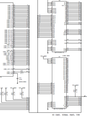

We have connected SDRAM and NAND flash on semc bus on MIMXRT1051CVL5B target board. And We could not able to debug in SDRAM with the JLink script provided in SDK. However, we could able to debug in EVAL kit but not on our target board.
Kindly suggest the changes required in the jlink link script file.
PFA files.

Hi @venkataddagatla ,
Can you share the schematic of this part?
Jing
10,408 Views
venkataddagatla
PFA
10,399 Views
jingpan

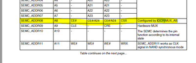

NAND Flash CE# is shared with SDRAM A8. This is not allowed. Because the pins function is configured by IOCR.MUX_A8. After SEMC is well initialized, this field can't be changed.

Actually we want to use SDRAM and NAND on Semc  bus. We had assigned the pins as mentioned in the Pin mux of the semc module. That is the reason you have seen the SEMC_ADDR08 connects to A8 pin of SDRAM and the same goes to CE# of NAND flash and all other as same as mentioned in the doc.
Is it possible by properly configuring IOCR register we can able to operate both without issues?
Kindly suggest, as we want to run our application from SDRAM and  want to store  data in NAND flash in runtime. Will it be an issue?

No. Please change NAND CE# to other pin.

Yes. IOCR can only be set during initialization. You can't change it frequently at run time. That doesn't make sense. But I can't find any other examples or cases like yours. Few new project use parallel NAND flash now.
