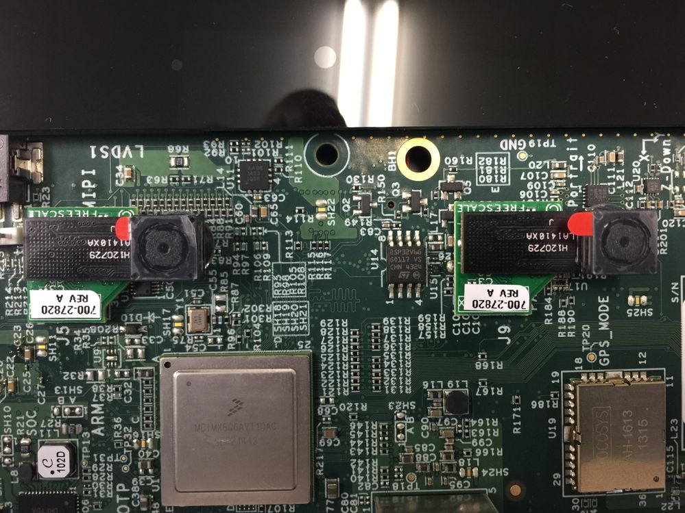

Hi all
Do you have a newest SDP schematics ?
I bought a new SABRE-SDP and  see a schematic.However, there are some difference between a board that I bought and schematic.
The board are added green color boards that is shown in attachment in CSI I/F
Does someone have a schematic for additional boards ?

Hi ko-hey
seems this additional board is SPF-27820_A IMX6SDPCAMADP
(to get camera 90 deg rotated). Suggest to enter support ticket
to obtain its schematic.
Latest SABRE-SDP designfiles:
i.MX6_SABRE_SDP_DESIGNFILES : Design files, including hardware schematics, Gerbers, and OrCAD files..
Size (K): 11725 Format: zip Rev #: C4 Modified: 10/15/2014

Hi Igor
Thank you for your reply.
I have another question.
According to the latest schematic, MIPI CMOS Sensor is OV5640 and Parallel CMOS Sensor is OV5642.
However, the board that I bought had two OV5640 for both MIPI and Parallel.
Is these inclusions for SDP correct ?

Hi ko-hey
you can look at BOM file for included parts,
suggest to apply to local marketing for differencies.
