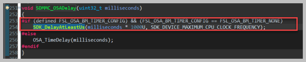

We are working on a project based on IMXRT1050 – EVKB where fatfs is implemented using SDcard, according to NXP example.
We are facing a stranger behavior regarding SDMMC_OSADelay() function, when instead delay milliseconds, it take several minutes.
The stranger thing is when this happens. The fact to add or remove some code from anywhere from software, causes the SDMMC_OSADelay() to work well or not.
Example when everything works fine, including Sdcard:
Hw_and_sw_initialization();
SD_PollingCardInsert();
Foo_func(); //this function just return 1.
Example when SDMMC_OSADelay() take minutes:
SD_PollingCardInsert(); // software get stuck here for several minutes, and when continue, SDcard is not working.
//Foo_func(); //this function just return 1.
Any help will be welcome!
Angelo.

Thanks for the clarification!  I see that you are using the baremetal implementation relying on the SDK_DelayAtLeastUs
Please help me testing  DWT and check  if the delay given to this function is not too big, try  a smaller value.
Below an example screenshot using RT1064 and MCUXpresso.

angelo_76
Hi @diego_charles !
Thanks for the response, but in this case, I'm running on bare metal.

diego_charles
Hi @angelo_76
Diego
