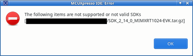

stefanct
Are there any news about this? I am a first-time user of mcuxpresso and neither the in-built download nor the manual install works for me.
Dropping the .zip downloaded from the SDK builder into the "Installed SDKs" view results in the following dialog with an deactivated OK button (presumably because the .manifest field is left empty... because I don't know where it should come from):
Using the alternative via "Import archive..." results in
All of this with MCUXpresso IDE v11.8.0 [Build 1165] [2023-07-26] on Debian stable (12).
