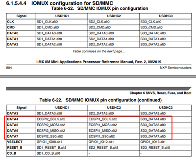

Hello everyone,
When designing imX8Mini hardware, customers will switch emmc from SDHC3 to SDHC1.
I have some questions about the following part of the imx8M Mini Reference Manual. The RM contains the following information:
ECSPI2 and ECSPI1 in the reference manual are not configured with alt2 MUX.SD3_DATA could not be queried in the manual.
I have some questions about the description of this chapter.
I have some questions about whether emmc can be boot with SDHC1 in imx8Mini.
Whether emmc can be boot in SDHC1.
How should I configure emmc if it can be boot from SDHC1?
Thank you for your attention

I have discussed with our colleague, and he write a document , You can see the document create by our engineer today https://community.nxp.com/t5/i-MX-Processors-Knowledge-Base/Enabling-uSDHC1-of-i-MX8MM-Based-On-L5-4...

The emmc can be boot in SDHC1. You need to configure the SDHC1 clock in u-boot. The details on the SDHC1 configuration I will share to you later.
