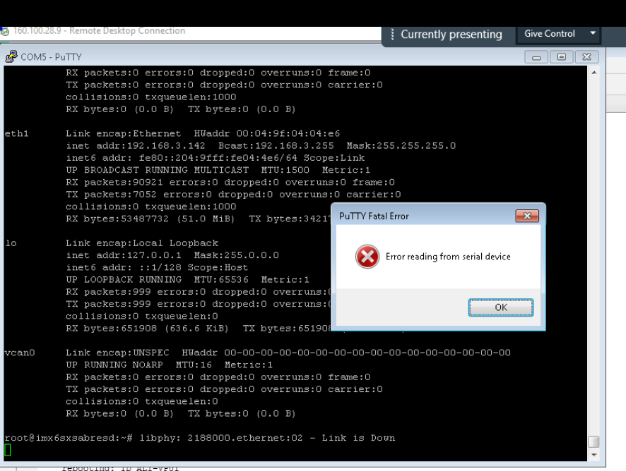

Hi Team,
i am working on iMXS6X-SDB board with our custom linux kernel image version 3.14.28. I have some python reboot tests which gives the reboot command via ssh, waits for some time and this cycle repeats.
While running those tests, when serial port was connected(A9), i saw below log trace on the console before eth1 dropped off the network:
libphy:2188000.ethernet:02 - Link is Down
and the board looks completely in hang state with no ethernet LEDS glowing (orange and Red color -nearby ethernet connector).
Also, serial port looks down - since also i cannot login inside the board to see more information inside dmesg and/or /var/log/messages.
Please let me know if you need any further details. I am not sure why eth1 link drops off after its power cycled multiple times.
This is seen when its power cycled over several hundreds times (though it may fall at any random attempt).
Note- that Sabre board is connected to gigabit ethernet switch and from python (running on PC desktop) is connected to gigabit ethernet switch via USB-gigabit adaptor in between creating a local network.

Also, when the eth0 interface is down, we see below log trace on serial port - (and later on serial port is not accessible)
Poky (Yocto Project Reference Distro) 1.7 imx6sxsabresd /dev/ttymxc0
imx6sxsabresd login: hrtimer: interrupt took 181667 ns
I always gets above message on serial port when eth1 interface is down after reboot multiple times.

My senior engineer at my company tried as per your suggestion, below is the replied i got from him:
A couple of things:
  • The capacitor I added doesn’t extend the output reset pulse, it delays detection of the reset input signal!  I now have to hold the reset button for 2.7seconds before a reset is generated – I’ll take the cap off again.  I don’t think I can extend the reset duration as the reset controller chip has a fixed reset pulse duration of 210ms (140ms – 280ms).
  • The Watchdog output from the i.MX6 IS high following a power on, then goes low when a reboot command is issued.  It then stays low and never returns high.  This means that a 210ms reset pulse is generated the first time a reboot command is issues after a power on, but isn’t issued subsequently.
Can you please have a look at above two points made by him.
