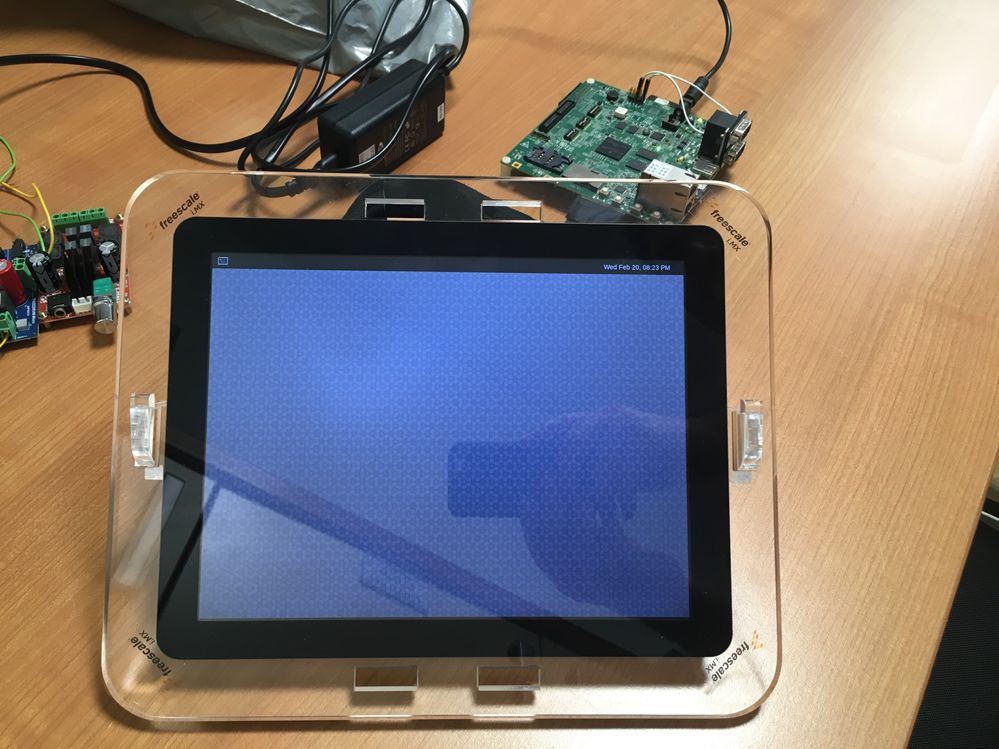

Hi everyone,
I'm a newbie on Yocto and imx processor is imx6sx with sabre board. To learn and revise Yocto, I have downloaded your binary demo file and win32diskimager. I have been able to download that image successfully to SD card and run. After that, connected via UART and get information about device. However, can't find out and run a qt examples application. Where are these applications on Yocto and how can I run these?
Also, your demo file which was downloaded from your have no GUI desktop but I have seen in videos it has a GUI. What should I do in order to it has a GUI?
Finally, could you give a book or reference manual (except yocto manual) to develop my own distro and recipes which have a real application with qt? So, it should practical.
Thank you!

gokhansahin
Yes, I have downloaded the 4.14.98 binary file.
My problem is that there is no menu on LCD after getting the display.
I enclosed an image of this.

ankitr_patel
Senior Contributor II
Hi Gokhan Sahin,
Yes, the pre-built image is a validation image. It just display GUI without any QT content.
You need to build fsl-image-qt5-validation-imx to get QT applications.
Please refer to the https://www.nxp.com/docs/en/user-guide/i.MX_Yocto_Project_User  for more information.
