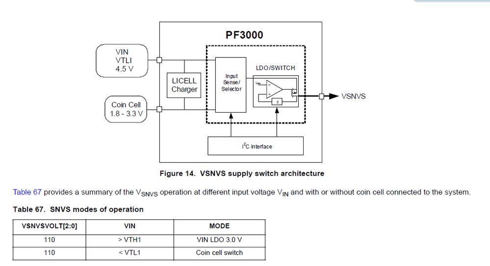

frank_zhang
Hi ho-key,
    I get some update from PMIC SE.
When VIN> LICELL, VSNVS is powered by VIN.
[Frank] Based on the Table 67 in below figure, it seems that VSNVS is powered by VIN when VIN > VTH1, not VIN>LICELL.
In this case, we guess some reverse current will occur from PMIC to battery.
   [Frank]
               When the VSNVS is powered by VIN, there is no connection between Coin Cell and VSNVS.
                If we don’t enable the LICELL Charger, there is no current to battery.
               If we enable the LICELL Charger, Coin Cell will be charged by VIN via LICELL Charger, and still disconnect to the VSNVS at this time.
               When VIN<VTL1, VSNVS will switch to Coin cell for power supply.
    Thank you!
Frank

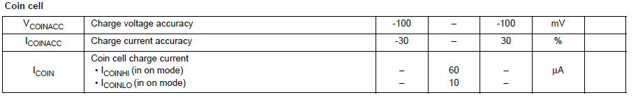

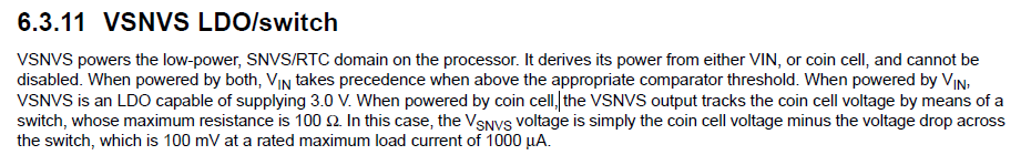

frank_zhang
Hi Ko-hey,
     Did you mention the Coin chell charge current?
     And there are a limit for the maximum load current from coin cell to VSNVS(1000uA)pastedImage_2.png
     Also you can refer to this chapter for the switch logic. Thank you!
Frank

frank_zhang
Hi ho-key,
   [Frank]
    Thank you!
Frank
4,332 Views
frank_zhang
Hi ho-key,
    I can't find the reverse current path based on figure 14 above. I will confrim with pfuse SE tomorrow and let you know.Thank you.
Frank
