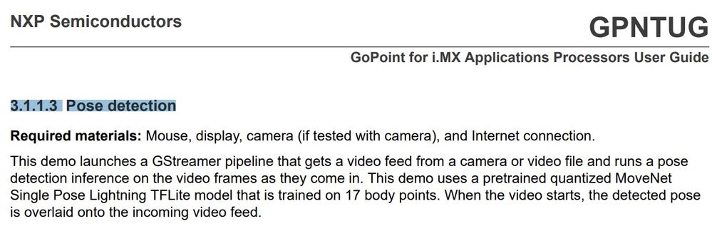

The refer the example.py in https://github.com/NXP/eiq-model-zoo/tree/main/tasks/vision/pose-estimation/movenet and test movenet with Gopoint

I found the source code of pose_estimation in the Gopoint, need to notice that you need choose correspond verison.
https://github.com/nxp-imx-support/nxp-demo-experience-demos-list/blob/lf-6.6.52_2.2.0/scripts/machi...
The errors you meet seems from the model, please try below model which is used by Gopoint
https://www.kaggle.com/models/google/movenet/tfLite/singlepose-lightning-tflite-int8
