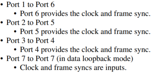

Please let me make clear about below questions.
 1) Each SSIx(x=1,2,3) is included STCK/STFS/SRCK/SRFS/STXD/SRXD signal lines?
 2) Each SSIx(x=1,2,3) are connected to internal port 1/2/7 of AUDMUX. Is this understanding correct?
 3) we can set port to port connection inside AUDMUX?(default configuration is below figure)
yuji

igorpadykov
Hi Yuji
1. yes
2. this depends on used processor, for example for i.MX6Q it is described in
Table 81. AUDMUX Port Allocation
i.MX 6Dual/6Quad Applications Processors for Consumer Products - Data Sheet
3. right
