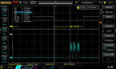

mehul_dabhi
I am using the i.MX8MP SoC and have configured the SPI frequency to 25 MHz and am writing 24-bit data. However, I am observing an extended CS (Chip Select) low time of approximately 2.2 µs before the SCLK (Serial Clock) starts, as seen in the captured image.
What steps can I take to reduce the CS low time before the SCLK begins? Any guidance or suggestions?

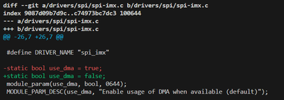

pengyong_zhang
Hi @mehul_dabhi
You can disable the DMA to implementation for your needs.

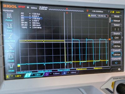

mehul_dabhi
Hi @pengyong_zhang,
I followed your suggestion and disabled DMA as a result I have been able to get the delay lowered down to around ~500ns for 1MHz I have attached the snap of it.

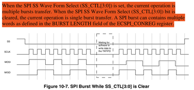

I am interfacing DAC to ecspi2 and I have gathered following understanding from the reference manual of imx8mp.
With the configuration of ECSPIx_CONREG[SMC] =1, I can immediately start the SPI transfer once the data is in TxFIFO and with ECSPIx_CONFIGREG[SS_CTL] = 0, the data should be transferred without the asserting the CS between the consecutive bursts until the ECSPIx_CONREG[BURST_LENGTH] is transferred . Below are the snaps for this.
Based on this theory we have selected and designed the hardware. So as I mentioned in my previous comment what can be done to meet my requirement? Or is there some problem with the reference manual? Or have I misunderstood something?

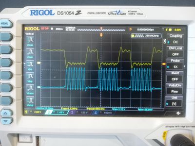

mehul_dabhi
Hi @pengyong_zhang ,
I have attached the the waveform image below, the signal in yellow is CS gpio and the blue one is SCK of SPI.
I also tried configuring the cs_setup delay from spi_device structure but it too does not lead to any improvements. I have to write around 300K samples in a sec to a DAC and if this delay persists this will become an impossible thing for me to do.
Mehul
