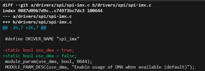

>> 1. Configure the SPI node as per shared snap of dts.
    2. Disable dma from spi_imx.c as below snap
     3. Transmit some data over SPI.

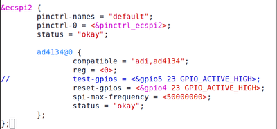

Also, please share your Device tree related to SPI.
A captured Image of signals would be helpful.

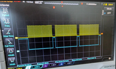

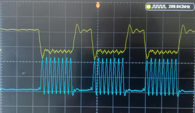

>> When I switched to native CS I had observed below waveform when I was trying to transmit 24bits with 8 bits-per-word (Yellow - CS & Blue - SCLK). So the CS was going high after each byte transfer.
To resolve the above issue I was suggested to disable DMA as I mentioned in above steps and got it resolved (below snap yellow - clock and blue - clock).

Actually, this behavior is expected. When you are using the SPI as Master, the CS signal should be an IO pad, then the driver will handle when CS should be asserted.
When you are using the SPI as Slave, you should select the CS signal as the dedicated CS.
You can see this examples on device tree (i.MX93 just for reference):
and
Please try changing the native ECSPI2_SS0 for any GPIO without disable DMA.
Salas.

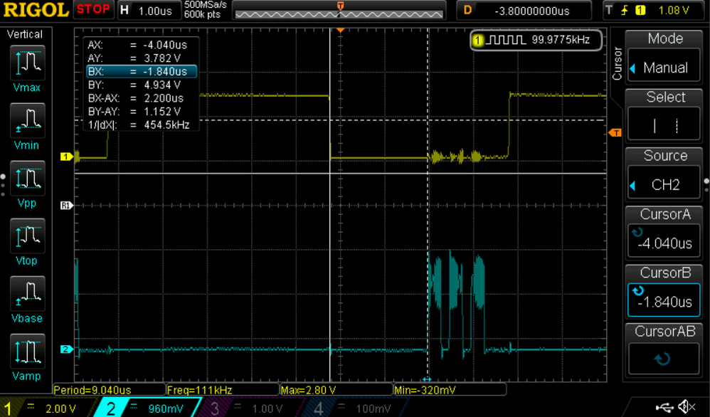

>> Initially this is what I had configured and had faced an issue of the delay between CS assertion and first rising edge of SCLK and then switched to dedicated CS.
The original issue link is here. Also below is the snap for your reference.
So if I use the GPIO pad for CS won't I face this issue again and go back in the same loop?

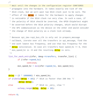

I tried tweaking the driver source and I could only find hard delay being used in the section shown in the below snap.
Here, the delay to be generated was found to be 0. Apart from this, is there any hard delays that might affect? If I intend to reduce these delays, where would you suggest I make changes to improve the throughput?
