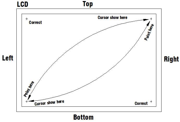

thomaslin
Hi Otavio,
According to do experiment, get the touch misalignment result as above.
If possible cause by fsl BSP's ADC setting?
Thanks again.
9,698 Views
fabio_estevam
Which kernel are you using: 2.6.35 or 3.8?
9,698 Views
thomaslin
Linux imx28evk 2.6.35.3-10.12.01+yocto+gc0879e9
9,698 Views
OtavioSalvador
Senior Contributor II
I've sent a 3.8 update to meta-fsl-arm and it includes a fix done by MarekVasut which fixes the offset problem we had. You may give it a try?

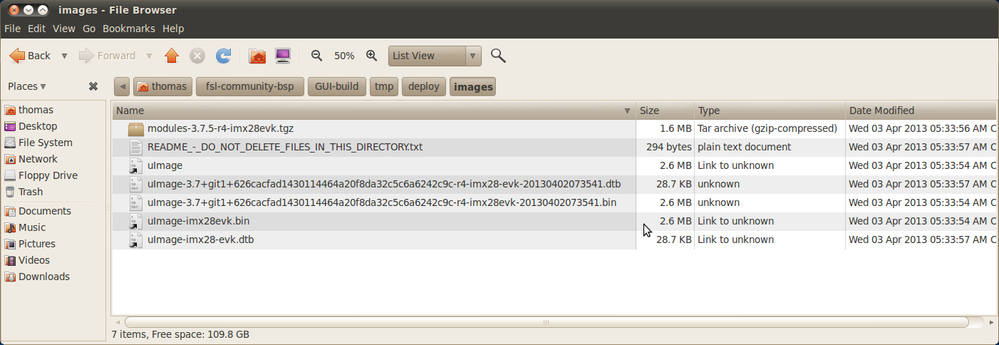

thomaslin
Hi Otavio,
Reinstall Ubuntu 10.04 and add the local.conf file:
PREFERRED_PROVIDER_virtual/kernel = "linux-fslc"
Then bitbake fsl-image-gul.
Can't find out .sdcard file in image folder. What procedure I miss?
List local.conf  content as below
MACHINE ??= 'imx28evk'
DISTRO ?= 'poky'
PACKAGE_CLASSES ?= "package_rpm"
EXTRA_IMAGE_FEATURES = "debug-tweaks"
USER_CLASSES ?= "buildstats image-mklibs image-prelink"
PATCHRESOLVE = "noop"
CONF_VERSION = "1"
BB_NUMBER_THREADS = '2'
PARALLEL_MAKE = '-j 1'
ACCEPT_FSL_EULA = "1"
INHERIT += 'rm_work'
9,697 Views
OtavioSalvador
What image did you use for the build? I usually use core-image-base to check all is fine before to use a bigger image.
