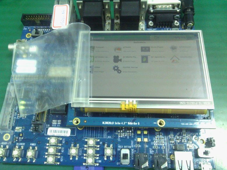

Hello; we did try to calibrate it and it seems xinput-calibrator cannot cope with it.
Please check git.shr-project.org Git - meta-smartphone.git/blob - meta-openmoko/recipes-graphics/xinput-calibrato... for an example of how to calibrate it using xinput.
1,898 Views
thomaslin
Thanks this great idea.
But I can't run xinput in debug console. Debug port show "unable to connect to X server"
Plugin USB keyboard, no USB device detect.
Run "lsusb", only show 1d6d:0002 2.0 root hub x2.
Try to find a way to run xinput that connect xserver.
Any good idea to solve this?

It is not needed; you can calibrate it. You can use xinput-calibrator to generate the calibration data and it can provide the calibration and invert the axis.

Dear Otavio,
Thanks your great answer.
Change machine as "imax28evk"
Build in progress now.
1,898 Views
OtavioSalvador
Senior Contributor II
Sure; use imx28evk as machine name.
1,898 Views

thomaslin
GUI image work so far.
