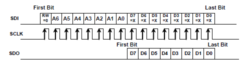

Below is the timing of SPI read of a SPI device.
#define DEV_SPI    "/dev/spidev0.0"
static uint8_t spi_transfer(int fd, uint8_t *tx)
     int ret;
     uint8_t rx[ARRAY_SIZE(tx)] = {0, };
     struct spi_ioc_transfer tr = {
    .tx_buf = (unsigned long)tx,
    .rx_buf = (unsigned long)rx,
    .len = 2,
    ret = ioctl(fd, SPI_IOC_MESSAGE(1), &tr);
    if (ret == 1)
    printf("can't send spi message.\n");
    return rx[1];   // rx[0] is not the data read from the device, rx[1] is the data D7-D0.
static void SPI_Write_register(int fd, uint8_t reg, uint8_t val)
    uint8_t tx[] = { 0x00, 0x00, };
    tx[0] = 0x80 | reg;     // the first bit is 1 for SPI Write
    tx[1] = val;
    spi_transfer(fd, tx);
static uint8_t SPI_Read_register(int fd, uint8_t reg)
    tx[0] = 0x7F & reg;   // the first bit is 0 for SPI Read
    tx[1] = 0xFF;
    return spi_transfer(fd, tx);
