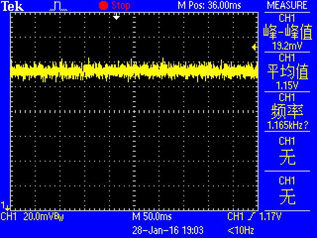

Hi,guys
We do our luncher stress test, it wille happend kernel panic, look like this:
Similar problems:
Random crash at imx6dl with Android 4.4.2
The board is our own design,I have do ddr stress, it look like ok, no error.
So what can i do? This issue had block me for a long times.

igorpadykov
Hi pengchuan
issue may be caused by some of gpu errata (note, many were fixed in next
releases), try attached patch or hardware : please check VDD_SOC_CAP
voltage and its ripples.
igor
3,183 Views
igorpadykov
Hi pengchuan
igor
3,182 Views
inuyasha
Hi, igorpadykov
I will porting patchs to our bsp, and feedback later.
We also met random crash without any panic info, the ripples of VDD_ARM_CAP, VDD_SOC_CAP and VDD_PU_CAP seem ok
Particularly relate with usb, like carplay, hotplug usb device, usb music...
We also met random crash while booting, without any panic info, system hang.
Board is our design, kernel version:3.0.35, hardware:imx6d
So how to check or fix those random crash issues, thanks!
BR,
pengchuan.tang
3,182 Views
jiujinhong
Hi tang,
are you fixed this issue?
3,182 Views
inuyasha
I apply patchs by igorpadykov provide,  our software test engineer recheck all random crash issue seems not exsit.
