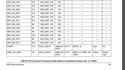

Yes, but it doesn't show what replaces the MIPI in models that doesn't support it.
The pin description is same for all models on the datasheet, how this will change or it will be used as GPIOs ?

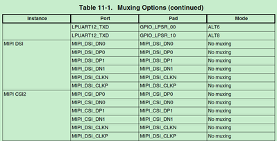

If customer check RT1170 reference manual, which shows MIPI pins most are not muxing with GPIO function:

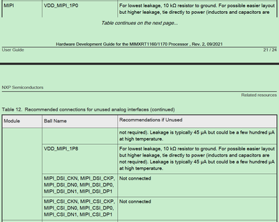

I would recommend refer RT1170 hardware design guide to handle those MIPI pins of RT1170 chip without MIPI function/modules.

Thank you for your reply.
Models without MIPI will have the same pin layout.
From the hardware guide MIPI pins should be left unconnected since MIPI is not supported.
So, all the models are pin compatible.
